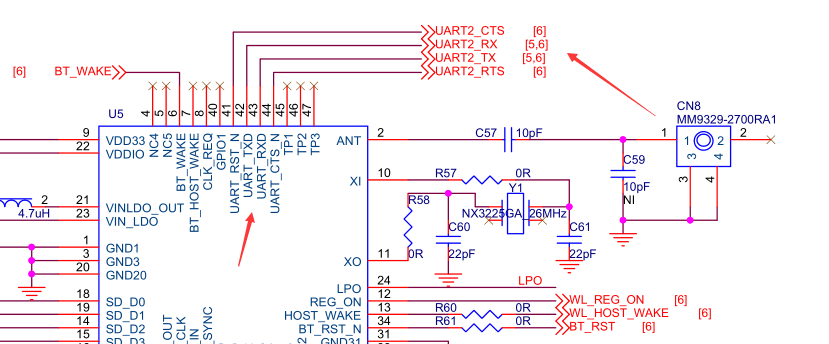

I meet some problem about Imx6ull uart2 comunicating problem. I connect "UART2_TX_DATA",  "UART2_RX_DATA", "UART2_RTS_B", "UART2_CTS_B" to a BlueTooth module.
Firstly, the schematic is as bellow:
Secondly, the DTS configure is as bellow:

1.  I had configured the 4 pins to GPIO and test their electrical level, I confirm that the 4 pins is OK connect to CPU.
2. when I  use DCE mode and run a application about uart , the "UART2_CTS" is HIGN, "UART2_RTS" is LOW, "UART2_TX"& "UART2_RX" have no signal out in tthe oscilloscope.
3. But when I use DTE mode(the hardware is not change in the DCE mode),  the "UART2_CTS" is HIGN, "UART2_RTS" is LOW,  "UART2_RX" have signal out in the osccilloscope.
4. So I confusion when I use UART2 to communicaton to my BlueTooth module, Should I use the DTE mode and change the Hardware to the DTE mode??? Or what the exactly problem is?

igorpadykov
Hi Wuxiuxin
DTE differs from DCE mode by direction of some signals, it is better
described in sect.Table 86. UART I/O Configuration vs. Mode i.MX6DQ Datasheet
http://www.nxp.com/docs/en/data-sheet/IMX6DQCEC.pdf
You can use mode which is working fine.
