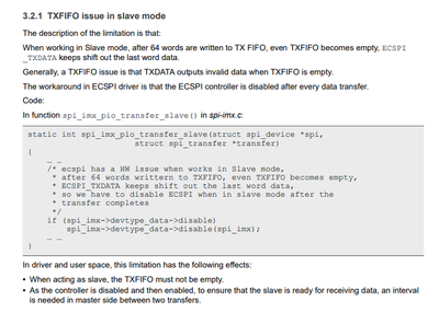

Hello @j_george
I hope you are doing very well.
Please refer to the chapter 3.2.1 TXFIFO issue in slave mode of AN13633 (Using Enhanced Configurable SPI (ECSPI) as Slave in Linux). That application note describe perfectly the issue you are having:
Also the chapter 3.2.3.1:
It appears it is an issue on the TXFIFO and spi-imx driver.
I hope this can helps to you.
Salas.

j_george
Hello Alejandro_Salas,
Thank you. We had seen this Application Note and we ran some tests:
About 3.2.1 - The issue describes that the last data repeats after 64 words and that it happens with the TX FIFO is empty. But in our case, we ensure that TXFIFO is always at least 50% full. It is never empty and we confirmed this by monitoring the TXFIFO EMPTY status flag. The FIFO never indicates an empty. In our case, a word is just vanished. The next word is as expected.
About 3.2.3.1: This is where we have a doubt. In our case, the burst length is configured as 32Bits. And RX Threshold to 15. So the intention is that our SPI transfers are all 4bytes (1 word) and we get interrupts at 16 Words (1/4th of FIFO FULL). And in the ISR we fill the TXFIFO with next 16 words to send, to that TXFIFO is never empty. The SS is tied to Ground. So the SS is not toggling. Is that an issue? We are aware that there is an errata that says, SPI transfers cannot be ended with the SS Edge and should depend only on Burst Length. This is why we have disregarded the SS and also because this is a Point to Point link. So as per the errata, we should be safe.
I saw that the spi-imx slave driver in Linux is limiting the transactions to max 64 words and at the end, the ECSPI block is disabled and enabled. In our case,  even the first 2 words are missing after disabling and enabling the block.

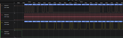

5,275件の閲覧回数
j_george
We tried with controlling the Chip Select from the master and we still see that the second word from the slave (IMX6ULL) is missing.
Here is the capture from the logic analyzer.
So the CS is not solving our issue here.
