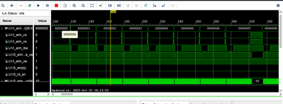

Hello everyone,
I am using the EIM interface of IMX6ULL and FPGA communication, using synchronous transmission (read write),       0x50000000 to 0x50000100 are the addresses corresponding to control commands, 0x50000200 to 0x50001000 are the addresses used for large amounts of data (DMA), the bus used is 16 bits (0-15), burst len=32.
1. In synchronous mode
At present, I have no problem writing control commands to 0x50000000, but when I write data to the address of 0x50000002, the FPGA still receives the address of 0x50000000.
But when I increase the address to 0x50000040 (32 * 2), I can write data again and the address is normal. Is this phenomenon related to burst len=32?
But I want to use the address 0x50000002, how can I solve this problem?
2 In asynchronous mode
I have no problem writing control commands to 0x50000000, and I can also write data to 0x50000002, but it will continue to be written to 0x50000004...... 0x5000000E, the written value is the same as 0x50000000, which affects the data in other addresses.

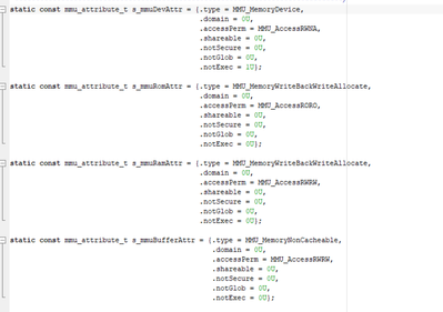

As with the previous question, the memory type setting is incorrect and should be set to
s_mmuDevAttr。
As shown in the following figure
还是内存初始化时的内存类型设置的不对,应该设置为
s_mmuDevAttr.
for (i = 0; i < 32; i++)
MMU_ConfigSection(MMU_L1Table, (const void *)(0x0C000000U + (i << 20)), (0x0C000000U + (i << 20)),
&s_mmuDevAttr); /* QSPI Rx Buf */
for (i = 0; i < 256; i++)
MMU_ConfigSection(MMU_L1Table, (const void *)(0x50000000U + (i << 20)), (0x50000000U + (i << 20)),
&s_mmuDevAttr); /* EIM */
MMU_ConfigSection(MMU_L1Table, (const void *)(0x60000000U + (i << 20)), (0x60000000U + (i << 20)),
&s_mmuRomAttr); /* QSPI */
for (i = 0; i < 2048; i++)
MMU_ConfigSection(MMU_L1Table, (const void *)(0x80000000U + (i << 20)), (0x80000000U + (i << 20)),
&s_mmuRamAttr); /* DDR */
