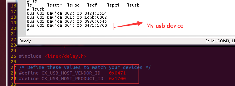

hi,
   I am use  platform is imx6ul,  linux kernel 3.14.38 . I am use the imx6ul as the usb host device ,  when  the usb in communication , I am pull out the usb port,  the device prompt the error :
   usb 1-1.2: device no response, device descriptor read/64, error -11   .  How can I solve  this  problem ???

rajathks
Which USB Device are you trying to connect to the processor ?
11,538 Views
linhaiboyy
I use imx6ul as usb device and  other one  imx6ul device as  host  .  Devices use kernel code , it is printer driver code ,modify  PID and UID,  it can  communicate to each other.  Non communication, usb host and usb device plugged normal.  Communication ,  usb host and usb device plugged abnormal, and  the usb host prompt the error :   usb 1-1.2: device no response, device descriptor read/64, error -11
11,538 Views
rajathks
Can you send me the DTS file where you changed the USB configuration to HOST ?
11,538 Views
linhaiboyy

linhaiboyy
The usb device can be detected on the  imx6ul processor in HOST mode . I am use  lsusb can find my usb device , and can find some other USB device
