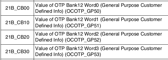

3,025 Views
Dhruvit
Hi @logman,
I hope you are doing well.
One should not use the above-mentioned equation.
To get the correct offset, One should see 35.5 OCOTP Memory Map/Register Definition in RM.
For Example,
fuse => bank 12 & word 0.
Then find out offset from  35.5 OCOTP Memory Map/Register Definition for bank12 & word 0;
Screenshot from 2023-07-05 15-50-42.pngScreenshot from 2023-07-05 15-50-42.png
Here, offset = 0xB00 & offset of the first word in 0th bank is 0x400.
Now, (0xB00 - 0x400)/0x4 = (0x700)/0x4 = 0x1C0.
I hope it helps!
