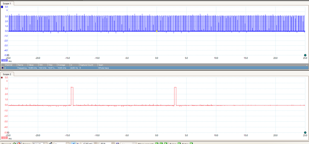

Hi, I was able to detect a video signal with VSYNC/HSYNC mode after modifying the lcd code, now I have few questions about the video format of the lcd entry.
1. Should MX6QDL_PAD_DI0_PIN4__IPU1_DI0_PIN04        0x80000000 be used in LCD group in dts file ?

And for this FB_SYNC_HOR_HIGH_ACT | FB_SYNC_VERT_HIGH_ACT, following are the HSYNC and VSYNC acquired at RGB port. Can you please verify these two signals ? :
Blue : HSYNC and RED : VSYNC
Anyway the encoded signal I have at cvbs output does not have color space, only leaving the color burst in the signal !!!

I've also attached the wave forms observed herewith, I'd be really grateful if you could take a look at them and advise me.....
Thanks in advance !
