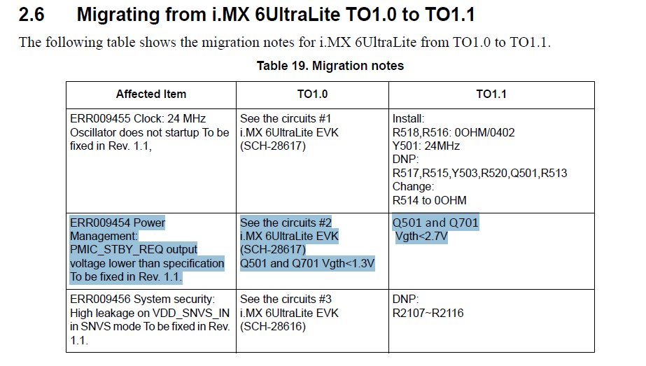

Hi Team,
In the image below (highlighted in blue) of the IMX6 ultralite processor Hardware Development Guide, the migration notes has a point on the PMIC_STBY_REQ output voltage. There, the MOSFET is told to be changed from Vgth< 1.3 to a Vgth<2.7V. Could you please tell a specific part number for the same. Please also tell me what is the voltage for the PMIC_STBY_REQ.
Shwetha
