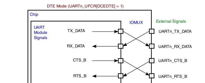

I'm trying to invert the Tx and Rx pin of the UART1 debug bus, on the sabresd board.
I try to change to DTE mode like this :
mx6sabresd.c
static iomux_v3_cfg_t const uart1_pads[] = {
IOMUX_PADS(PAD_CSI0_DAT11__UART1_TX_DATA | MUX_PAD_CTRL(UART_PAD_CTRL)),
IOMUX_PADS(PAD_CSI0_DAT10__UART1_RX_DATA | MUX_PAD_CTRL(UART_PAD_CTRL)),
imxqdl-sabresd.dtsi
pinctrl_uart1: uart1grp {
fsl,pins = <
MX6QDL_PAD_CSI0_DAT11__UART1_TX_DATA 0x1b0b1
MX6QDL_PAD_CSI0_DAT10__UART1_RX_DATA 0x1b0b1
&uart1 {
pinctrl-names = "default";
fsl,dte-mode;
pinctrl-0 = <&pinctrl_uart1>;
status = "okay";
But it doesn't work...
What am I missing?
Thank you for your help !

hello @Cécile ,
I hope You are doing well.
->The chip-level IOMUX modifies the direction and routing of the UART signals based on whether the UART is operating in DCE mode (UARTn_UFCR[DCEDTE]=0) or DTE mode (UARTn_UFCR[DCEDTE]=1). So one should always set DTE Mode.(UARTn_UFCR[DCEDTE] = 1)
->For DTE Mode One has to configure the pin setting of UART1_RX/TX_DATA & UART1_CTS/RTS_B as shown in the attachments. I've attached the attachments for the reference , please find the same.
