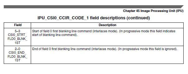

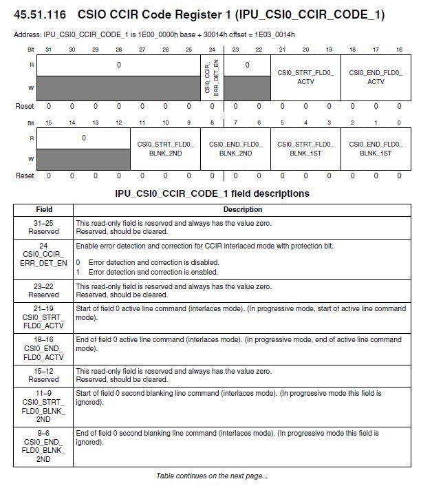

  BTW, could anyone explain the CSIO CCIR Code Register 1 ( IPU_CSI0_CCIR_CODE_1 ) to me? there is no detail explanation in the manual, such as the fields of:
       CSI0_STRT_FLD0_ACTV
       CSI0_END_FLD0_ACTV
       CSI0_STRT_FLD0_BLNK_2ND
       CSI0_END_FLD0_BLNK_2ND
       CSI0_STRT_FLD0_BLNK_1ST
       CSI0_END_FLD0_BLNK_1ST

Please check my captured images for the register.
Regarding this issue " When CSI0 mode is set to "progressive", the images flap upward and unstable"
Would you please adjust the value of "CSI0_VSC" in the "IPU_CSI0_OUT_FRM_CTRL" register.
