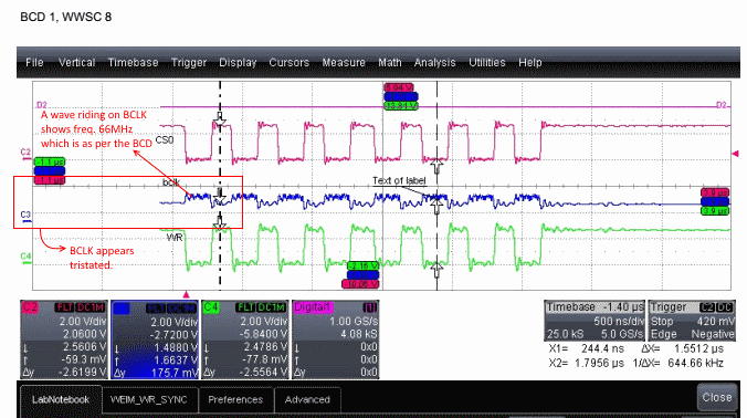

The problem is that the BCLK pad appears tristated and the BCLK clock cycles seem to be riding over this tristated signal, The write is being performed as I can see the CS, WR and ADV/LBA signals being generated.

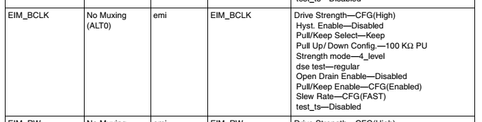

For the  IOMUXC_SW_PAD_CTL_PAD_EIM_BCLK, the configured setting is:
  • Pull/Keeper enabled
  • Drive strength HIGH.
  • Fast slew rate.
From the  reference manual, EIM_BCLK pad on the iMX51 is not multiplexed

Below is the captured waveform
The BCLK signal should appear as a 66MHZ square clock signal ideally. I am using an oscilloscope that has 400 Mhz bandwidth and using a DC 1MOhm coupling.

igorpadykov
Hi Deepak
"BCLK pad appears tristated " due to oscilloscope probe,
please try to get probe with more high impedance or (using existing)
decrease EIM frequency down for example to 10MHz and check
difference.
igor

igorpadykov
because lowimpedance/highcapacitance probe acts as rc filtering circuit
for high frequencies and you see average signal on oscilloscope.
Please try with more quality probe.

DeepakKukreja
Thanks Igor,
I could get to the root cause, it was because of averaging applied to the DSO channel because of which I was not able to see the Clock signal properly, I am able to see it now at 66 MHz.
Thanks a lot for your suggestions and help.
