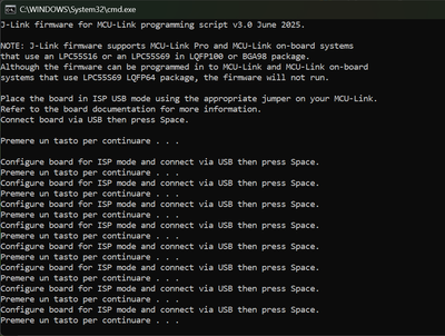

Hi, I a Simone's collegue I have this problem in my pc and I Installed last version of LinkServer, on-board LPC55 but nothing changes. I want understand where i can find il JlinkFW mentioned in "try testing with JLink FW", thaks

William_Weg
Hi Diego,
 I'm sorry but in any case doesn't work.
jp3 is close for isp mode

diego_charles
 Hi @William_Weg
thank you for your update!
I was able to update FW on my side
I placed  a jumper on JP3 and power cycled the whole EVK.
I am using this schematic revison:
What is the schematic revision that you are using? Does update also fails with CMSIS DAP?
Thank you,
Diego
