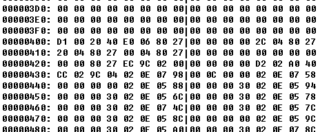

RodBorras
Thank you for posting the hexdump.
The file is clearly a padded U-Boot, so your first command (seek=2 skip=2) is correct, as long as it is done on the SD card (/dev/sdb) and not on the partition (/dev/sdb1).
Please note that there are parts of U-Boot that are Hardware-specific. If you have a custom board, you will need to customize those sections, and recompile U-Boot.
The Freescale image will not work on your board, unless your HW is pretty much identical.
It sounds like you got lucky on the previous version(s) of U-Boot that you tried, and unlucky on u-boot-mx6q-sabreauto.bin.

RodBorras
OK. Maybe you are trying to remove the padding of a U-Boot file that has no padding.
Could you please share the results of:
hexdump u-boot-mx6q-sabreauto.bin
We need the first 64 bytes starting at address 0x0000_0000:
- should be mostly zeros except for 32 bits
And also the first 64 bytes starting at address 0x0000_0400:
- should start with 00D1 4020
If the 00D1 4020 actually shows up in the first section (0x0000_0000) then you have a no-padded U-boot, and you have to omit the skip=2
Please advise.
