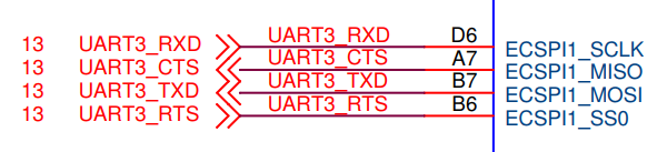

On IMX8mini has gpio's that gpio5-8 and gpio5-9 pins.
We are trying to control that pins using command input. When we do gpioset -c gpiochip5 8=0 then status was not changing for that. Observed on gpioinfo status was not changed.

Use --mode=wait with gpioset commands. Because, gpioset allocates the gpio line and drives it only until it exits. Then the line is deallocated an returns to its defalt state.

I don't see any DTS attached, you have to change it because they are UART3 flow control.
Which are used in EVK as UART flow control signals mapped to J1003.
In dtsi, they are used as UART 3 pins.
