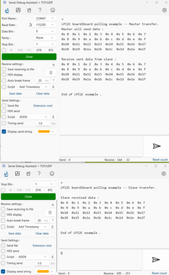

Gavin_Jia
Hi @sabesh ,
Have you tested the demo lpi2c_polling using two EVK boards? One as master and one as slave.
Here are my test results, since the demo works, it proves that there are SDA/SCL signals on J26Pin10/12.
