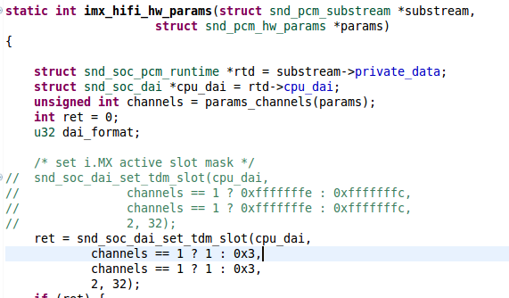

daveeewang
HI,Nicola,
have you finished your dsp porting work? i'am doing the same thing like u, i used the imx6q to connect the external dsp via i2s,imx6q is slave mode .i changed the dts , add the machine code,etc.then i can see my device and driver through the log,but when i use the aplay shell to play something,there is no voice,and the log print some infomation ,"aplay: pcm_write:1682: write error: Input/output error",i have coast a lot of time to debug this driver,i don't understand where should i can modify and fix now ?can you give me some advices?waitting for your news:D
thanks very much!
   ~jun

daveeewang
Hello,Nicola
   thank you for your reply.last week,i found out where the problem is .in the machine layer files,i refer to the imx-si476x.c file and modify the hw_params function,as follows,
