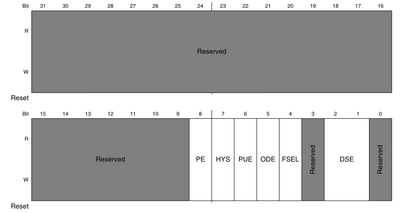

We have a board based around the i.MX8MP application processor. We are trying to optimize the signal integrity of an I2C bus. We have tried changing the pad settings. However, the pad settings do not seem to influence the signal at all. Is this expected? On our board, there is only a pull-up resistor and some sensors on the I2C bus.
As a test, we have also changed the pad settings on GPIOs. In that case, we see a clear difference between different pad settings. We have changed the driver strength, and the open drain enable setting on both the GPIO pads and the I2C pads. Does the behavior of the pad settings depend on the chosen peripheral? How should the pad be configured for an I2C bus?

Normally, in i.MX8MP the configuration pad is 0x400001c2 to the pad registers as you can see on device tree:
2 => DSE_X1
C => HYS and PUE enabled
1 => PE
and 4 => SION

I mean what happens when I configure the pad settings as 0x400001c6 instead of 0x400001c2? Or 0x400001e6? Will the interface stop working? Will the signal be less good?
Because currently, we are not able to measure any differences between the different options.

The recomended value is 0x400001c2, but yes, if you change some values the I2C interface can stop to work, for example if you enable the PE and you select Pull Down in PUE the interfaz will stop to work, because in I2C the lines must be Pull Up. Remember DSE is the drive strength field, higher DSE means more current that pad can drive (as output). Maybe if your design requiere to handle more distance between I2C master and Slaves, a Higher Drive Strength should works better.
