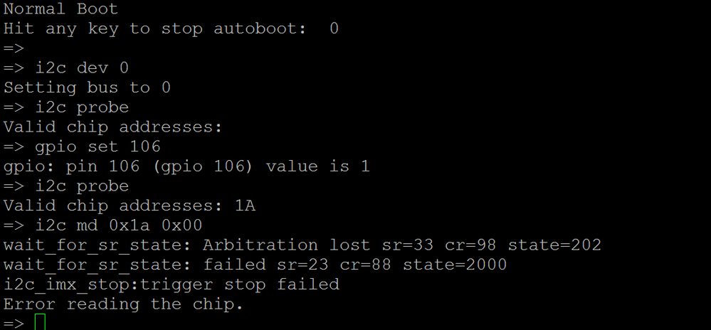

Hi Guys,
We have a custom i.MX6QD board. Instead of using WM8962 as codec we used WM8985 Codec.
I was trying to check the I2C Control interface.
i2c probe was able to display the address but i2c md is failing. Can anyone tell me what is going on here.

Hi Jamal
one can try to debug it in ..drivers/i2c/mxc_i2c.c or use i2c tools
All Boards I2C-tools
igor
