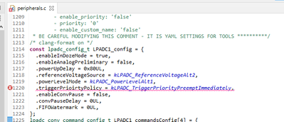

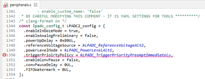

Hi Team
I'm using i.MXRT1170 and I found spell error on auto code generation.
II hope it will be fixed.
[Bug details]
wrong = triggerPrioirtyPolicy
correct = triggerPriorityPolicy

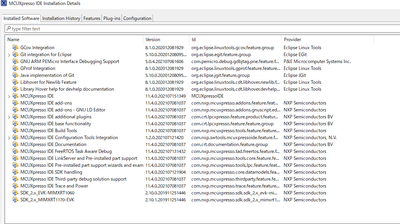

[IDE version I use]

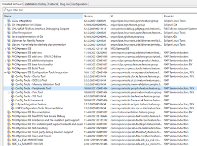

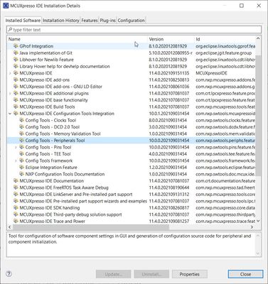

I haven't been able to reproduce this error, but my IDE is a slightly newer build. What I did found weird is that the version of the Config Tools integrations is very different.
Would you please provide the Peripherals Tool version and, would you please try installing a newer MCUXpresso IDE version to see if perhaps this error was already fixed in a subsequent release?

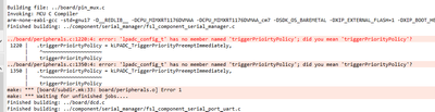

Thank you for pointing out this typo which leads to errors when setting up the ADC.
I tried replicating it with the MCUXpresso 11.4 and the i.MXRT1170-EVK SDK 2.10.1 to no avail. Would it be possible for you to please share the steps you followed to get this error? Or does it happen any time you configure the LPADC1?

Bug happens always when re-config the ADC settings.
On default IDE settings, rewrite the peripherals.c is not permitted.
So, it's a little work to fix the file every time.
I hope the bug fix as soon as possible.

I re-install the IDE. And now my Config Tool and peripheral tool version is same as yours.
But error not solved. I hope it will be fixed in the next update. Thank you.

This is Peripherals Tool verion I'm using.
