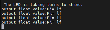

Hello.
When developing I.MX9352 Cortex-M33 with IAR1 9.50.2, it was not possible to output floating-point data via redirected printf.
The SDK used is SDK_2_16_000_MIMX9352xxxxM
The following Settings have been made in the IAR Settings.
Here's my code:

      PRINTF("output float value:Pi=%f %lf\r\n", Pi, Pi);

The actual effect is as follows:

Hi @HL_G
Please refer this case to modify PRINTF function in SDK:
https://community.nxp.com/t5/i-MX-Processors/i-MX8MP-Cannot-print-float-values-from-SDK-M7-examples/...

HL_G
Hi.@Zhiming_Liu
Thanks.
It seems that this approach is no better than using the sprintf function to convert to string output. Is there a way to print floating-point data directly using PRINTF?
Like this:
main()
double pi = 3.1415926;
PRINTF("pi = %f\r\n", pi);
The output:
pi = 3.141593
1,714件の閲覧回数
Zhiming_Liu
The existing PRINTF has a bit of a problem with float, or if you're not using serial printing and use printf inside the IAR
Zhiming
