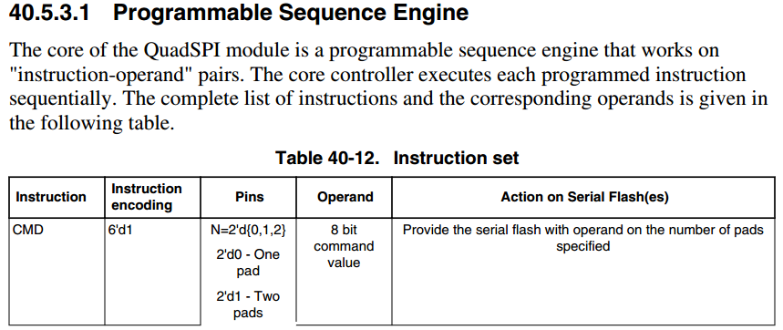

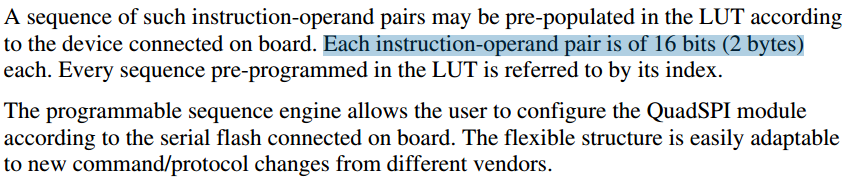

It looks like nobody actually answered the question about what the bold stuff means. Here we go...
Each Command sequence comprises of one or more 16-bit instructions.  Some instructions are followed by an operand, which is usually an address.
Each 16-bit instruction is coded as follows:
msb|15       10|9 8|7             0|lsb
   |   OpCode  | P |       Cmd     |
Where Opcode (6-bits [15:10]) is typically:
OPCODE_STOP       =  0, //Stop execution and deassert CS
OPCODE_CMD        =  1, //Execute command specified in the operand
OPCODE_ADDR       =  2, //Provide address cycles for 'operand' number of bits
OPCODE_DUMMY      =  3, //Provide the number of dummy cycles in the operand
OPCODE_MODE       =  4, //Send flash-specific mode specified in 8-bit operand
OPCODE_MODE2      =  5, //Send flash-specific mode specified in 2-bit operand
OPCODE_MODE4      =  6, //Send flash-specific mode specified in 4-bit operand
OPCODE_READ       =  7, //Receive from flash device the number of bytes in the operand
OPCODE_WRITE      =  8, //Send to flash device the number of bytes in the operand
OPCODE_JMP_ON_CS  =  9, //Jump to instruction index in the operand, if CS is deasserted
OPCODE_ADDR_DDR   = 10, //Same as OPCODE_ADDR, but transmit at each clock edge
OPCODE_MODE_DDR   = 11, //Same as OPCODE_MODE, but transmit at each clock edge
OPCODE_MODE2_DDR  = 12, //Same as OPCODE_MODE2, but transmit at each clock edge
OPCODE_MODE4_DDR  = 13, //Same as OPCODE_MODE4, but transmit at each clock edge
OPCODE_READ_DDR   = 14, //Same as OPCODE_READ, but transmit at each clock edge
OPCODE_WRITE_DDR  = 15, //Same as OPCODE_WRITE, but transmit at each clock edge
OPCODE_DATA_LEARN = 16, //Learn correct DDR sampling point using the given number of data bytes
OPCODE_CMD_DDR    = 17, //Same as OPCODE_CMD, but transmit at each clock edge
OPCODE_CADDR      = 18, //Provide column address cycles for 'operand' number of bits
OPCODE_CADDR_DDR  = 19, //Same as OPCODE_CADDR, but transmit at each clock edge
Where P (2 bits [9:8]) is the number of data pins for data transfer. Values:
DATAPINS_1 = 0, // Use 1 pin
DATAPINS_2 = 1, // Use 2 pins,
DATAPINS_4 = 2, // Use 4 pins
DATAPINS_8 = 3, // Use 8 pins,
Where Cmd - 8 bits [7:0] - NOR Flash Command as per the product Datasheet.

one can check sect.40.5.3.4 Look-up Table i.MX6UL Reference Manual
http://cache.freescale.com/files/32bit/doc/ref_manual/IMX6ULRM.pdf
and mfg tools (link below) qspi-header scripts
i.MX 6 / i.MX 7 Series Software and Development Tool|NXP
igor
