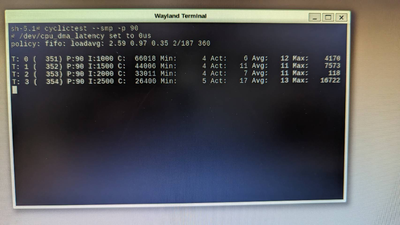

(1) I refer to the Real-time Edge Yocto Project User Guide.docx . I build a imx-image-multimedia-imx8mp-lpddr4-evk.wic image (5.10.72 + Real-time Edge 2.2) to download to SD card ,and run command as follows:
stress -i 4 --vm 10 --vm-bytes 10M --vm-hang 100 --timeout 100s
cyclictest --smp -p90 -m

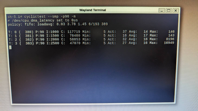

(2) I download  imx-image-multimedia-imx8mpevk.wic (5.10.72) to SD card ,and run command as follows:
(3) The actual difference between the two is not big in maximum latency time.
      Could you tell me how to verify real time edge function?
1,517 Views
AldoG
Please refer to the Real-Time Edge Software User Guide chapter 3.1.1 System Real-time Latency tests.
Aldo.
