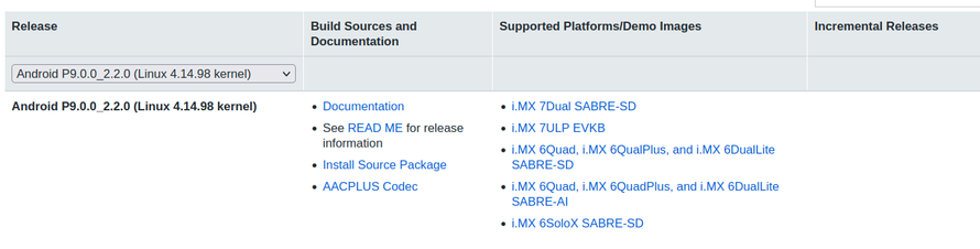

we are currently working with android 9 on imx6qp board and it has supported, we are using the source code from
https://www.nxp.com/design/software/embedded-software/i-mx-software/android-os-for-i-mx-applications...
