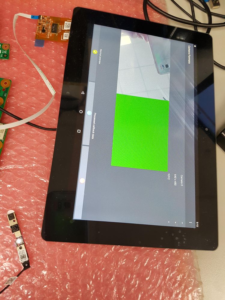

For using platform I.MX6QP and Android 6.0.1, test camera format is failed in CTSV R13.
CTSV need to test format N21, YV12, YUY2,(160x120, 176x144, 320x180, 320x240, ...,640x480).
Question list :
(1.) It test YUY2 format is failed for handing preview screen was show green screen.
For logcat issue log:
     01-18 03:10:50.856 221 1252 E imx6.gralloc: int GPUBufferManager::lockYUVHandle(private_handle_t*, android_ycbcr*) not support format:0x14
     01-18 03:10:50.856 221 1252 W GraphicBufferMapper: lock(...) failed -22 (Invalid argument)
     01-18 03:10:50.892 221 311 E FslCameraHAL: processBufferWithIPU:320, IPU_CHECK_TASK ret=12
     01-18 03:10:50.892 221 1252 E imx6.gralloc: int GPUBufferManager::lockYUVHandle(private_handle_t*, android_ycbcr*) not support format:0x14
     01-18 03:10:50.892 221 1252 W GraphicBufferMapper: lock(...) failed -22 (Invalid argument)
     01-18 03:10:50.924 221 311 E FslCameraHAL: processBufferWithIPU:320, IPU_CHECK_TASK ret=12
     01-18 03:10:50.924 221 1252 E imx6.gralloc: int GPUBufferManager::lockYUVHandle(private_handle_t*, android_ycbcr*)

Fail Piture:

Hi Terry
On my Android 6.0.1, the cts code and verifier is android:versionName="6.0_r14". Is it the same as yours?
I don't see the issue on our QA report, can the issue be reproduced in MX6QP Sabre board?
