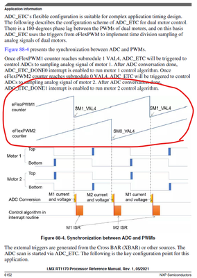

Hi Team
How can I shift the FlexPWM phase like below figure?
Tags (2)
1,685 Views
FelipeGarcia
Hi Kenji,
I recommend you to check mc_pmsm example that implements phase shift in three different flexpwm signals. The image you are referring is the counter representation of the PWM signal not the signal itself.
