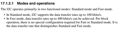

Actually, yes, modifying the device tree, you should be able to change the frequency of I2C3 for i.MX8MP.
But, you can see on the original i.MX8mp-EVK device tree, is it configured as maximum supported frequency (400 KHz):

Quick Question,
Where can I get the reference of that I2C of imx8mp-evk is configured as maximum supported frequency (400 KHz)?
It would be great if you give me a link.
