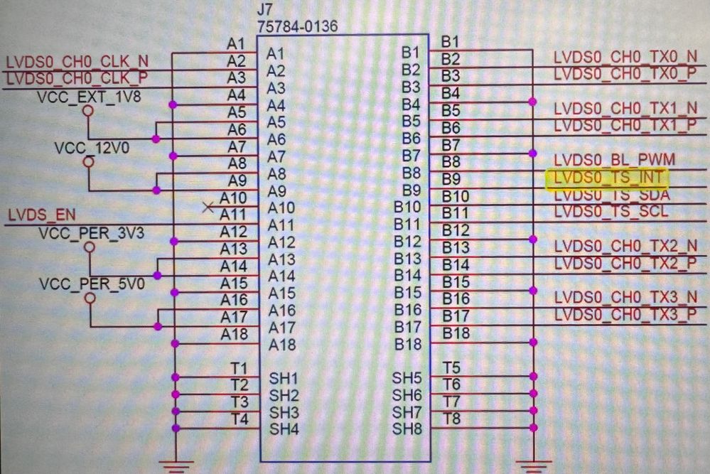

  1. I'm not sure what the IRQ vector is for the specific GPIO pin. I picked LVDS0_TS_INT pin (as highlighted pin in the below figure) as input touch interrupt but I couldn't find what the interrupt vector is.

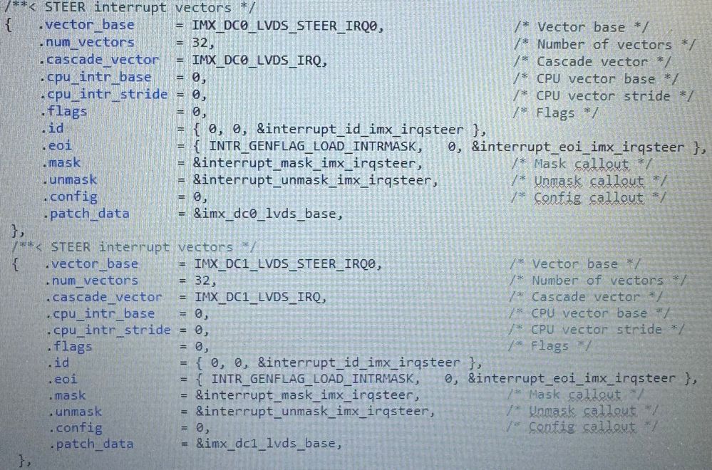

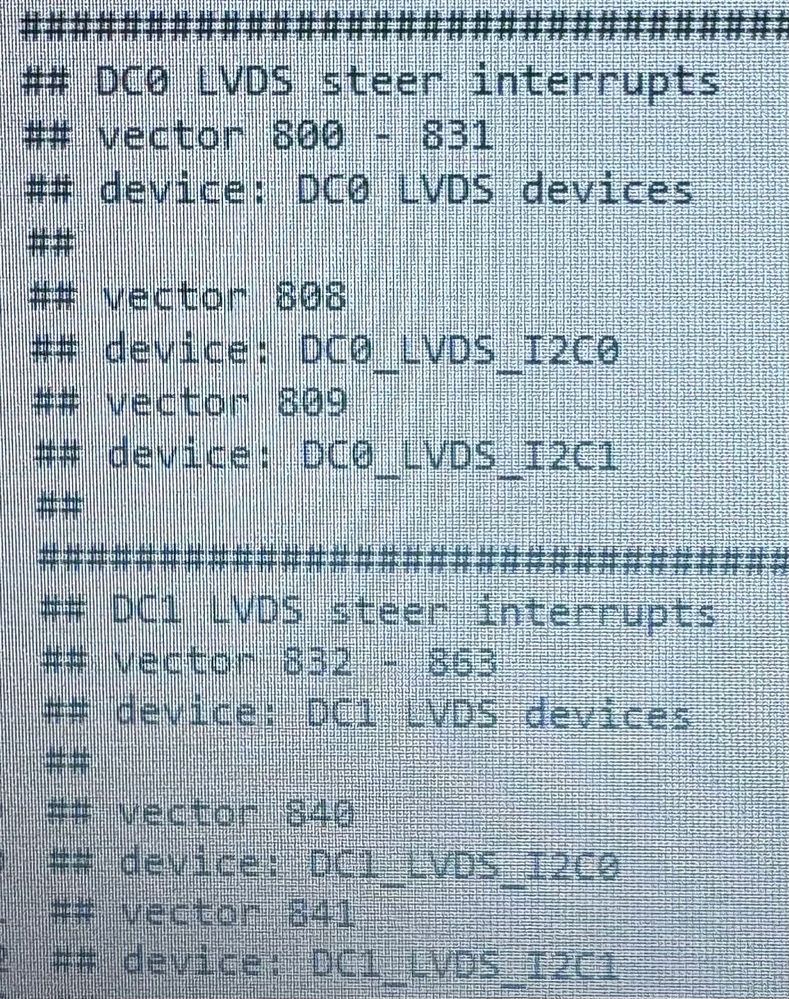

    I have found that the interrupt vectors for LVDS0 are in the range 800~831. However, I didn't know what exact the interrupt vector for LVDS0_TS_INT pin is.
    From imx8qm-cpu-mek-graphics.build:
    From imx_init_intrinfo.c:

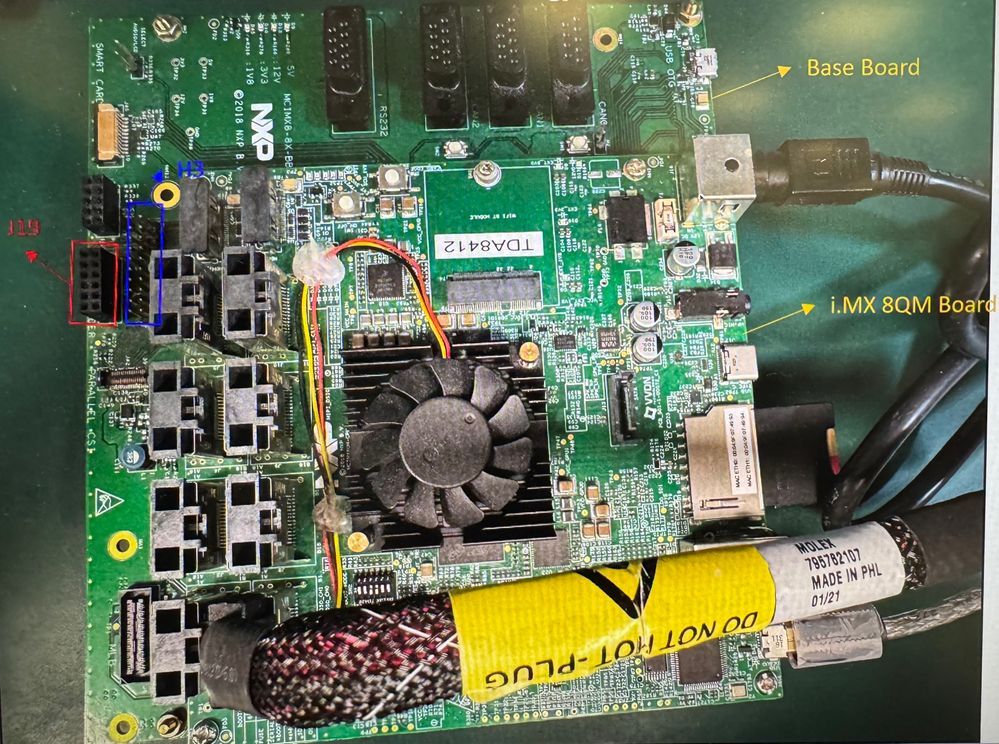

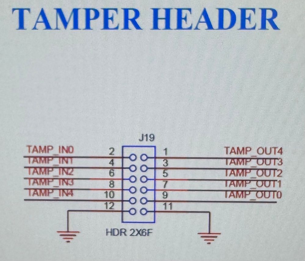

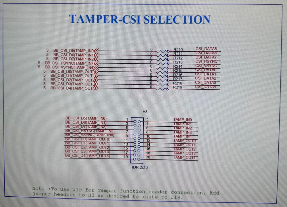

    Or is there any pin appropriate to be used as input touch interrupt? For example, H3 and J19 pin headers on base board. I mention these two pin headers only because they're connectable by "Dupont Line" but I'm not sure about if they're suitable for my case.

  1. What's the interrupt vector of LVDS0_TS_INT pin?
