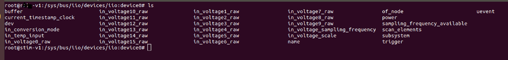

How do I read the  ADC values in IMX6ULL userspace?
for your information reference voltage is 3.3v
in /sys/bus/iio/devices/iio:device0/ I have the following itemsimg_x.pngsome communities say it is done as below
 awk "BEGIN{printf (\"%d\n\", (in_voltage0_raw + in_voltage_offset) * in_voltage_scale)}"
but in my case, there is no  in_voltage_offset
if I choose the in_voltage_offset as 0 , only one of the readings make sense

Reference voltage is 3.3v which is an actual regulator. however, every time after I power up my board and run "dmesg" Linux command, I see few kernel warning messages related to the ADC and the reference voltage as below:
[    2.568224] vf610-adc 2198000.adc: 2198000.adc supply vref not found, using dummy regulator
[    2.569165] vf610-adc 2198000.adc: Linked as a consumer to regulator.0

@Sanket_Parekh  Thanks for your reply,
Modified the device tree as instructed and resolved issue.
