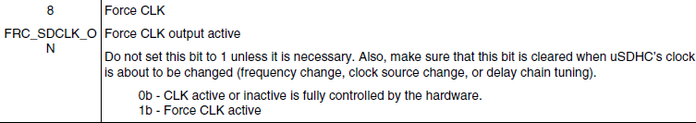

I am looking to keep the SD clock continuous for some debug.Kindly suggest if there is any register change which i can perform to keep it continueous.

Hi Yash:
I would suggest you refer to imx8mp Reference Manual,
10.3.6.1.29,  Vendor Specific Register (VEND_SPEC)
Bit 8 is for 'Force CLK',   you can try it.
