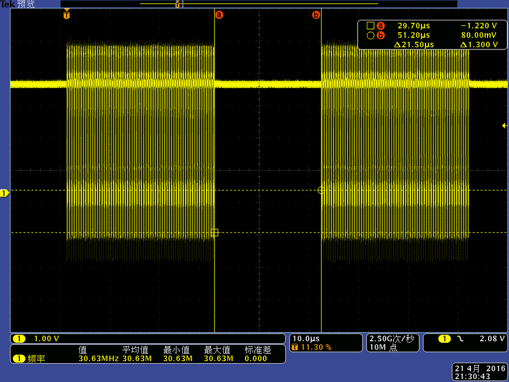

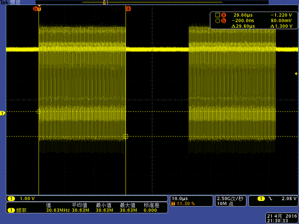

My platform is imx6ul. spi clk is 40M
I changed SPI dma dst_maxburst to spi_imx_get_fifosize(spi_imx) and sent about 1KB to measure timing.
Bellow is one burst (64 bytes) timing and with some delay and then is the next burst(64 bytes).
the whole wave is:
My question is: what cause the delay between every burst?
I notice there is risc processor to deal with sdma and fsl provide firmware.
So I guest that once the driver attach one dma request, then the firmware write data out and then read received data, that is, the delay between burst write operation is the time that read operation cost. Is it right?
And a another question is: how to reduce the delay between burst?
Thank you for your suggesion.
The delay between the bursts is caused by the SDMA deal with the SPI FIFOs.
Yes, there is the dedicated RISC core that controls the SDMA operation.
Yes, this is right.
Unfortunately, there seems to be no way to reduce this delay since SDMA always operates at its max. possible speed.
Artur
