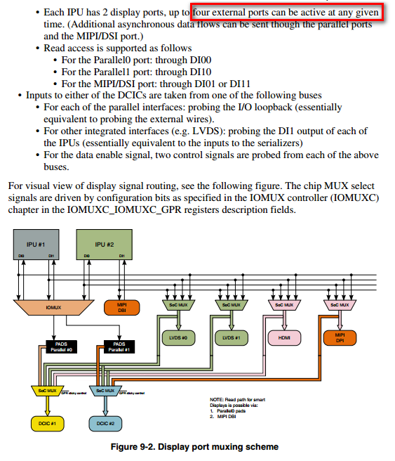

The 4 Display ports can be active at any given time in imx6Dual , How to  implement to play different video on difference display device ? (for example , 3 Display Connected via  LVDS0+LVDS1+LCD  or  LVDS0+LVDS1+HDMI , display different content )

Hi Michael
one can look at examples with gstreamer
GStreamer i.MX6 Multi-Display
https://community.nxp.com/thread/384600
