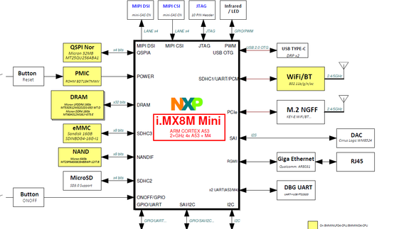

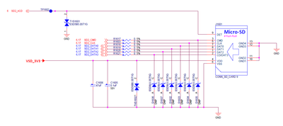

billwu
Dear Joanxie,
Thank for your information.
I have a question about the uSDHC1.  Is the uSDHC1 the same Micro-SD(SD2)(ref:below picture).
Sorry for the confusion, I said mmc1 means to Micro-SD.
B.R.
Bill
5,660件の閲覧回数
joanxie
pls see his :
SDHC2 is for MicroSD , SDHC1 is for IWFI/BT
5,653件の閲覧回数
billwu
Dear Joanxie
If I want to use SDIO interface of SDHC2, could I reference "https://community.nxp.com/t5/i-MX-Processors-Knowledge-Base/Enabling-uSDHC1-of-i-MX8MM-Based-On-L5-4..."?
B.R.
Bill
5,644件の閲覧回数
joanxie
yes, this document is for uSDHC1, if you need to use uSDHC2, you can refer to the document and change the dts according to your own design
