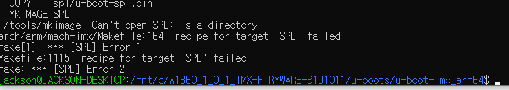

I am developing Wind10 IoT Core.
So I bought and testing the MCIMX8M-EVK.
1. When I build ARM64 FIRMWARE, I get the following "Can't open SPL" error: How should I fix it?
(enviroment : WSL, W1860_1_0_1_IMX-FIRMWARE-B191011)

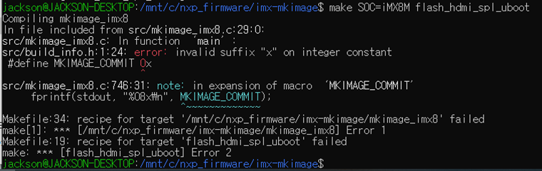

The following build error occurred while proceeding to the next step build.(make SOC=iMX8M flash_hdmi_spl_uboot)

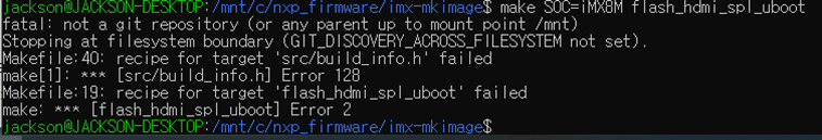

When I run the same build command again, I get the following error:
I think I need to get a git commit head, Source directly from the web.
(https://www.nxp.com/design/software/embedded-software/windows-10-iot-core-for-i.mx-applications-proc...)
How do I get the git commit head? Or is there another way?

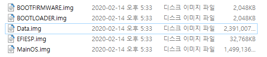

comfriend
Thank for your answer!
Is the image below correct?
I don't want images files, I want build error and fixes.(at source level)
I want to build WinPE and play it from SD to EMMC.
**** I am following the development process by looking at the guide document.(IMXWGU_i.MX_Win10_User's_Guide.pdf)

I fixed the error.
The following command is required after running WSL.
setfattr -n system.wsl_case_sensitive -v 1 u-boots/u-boot-imx_arm64/
