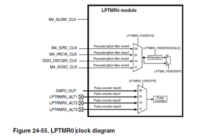

I am working on a project using example trgmux_lptmr_trigger_lpit as a starting point. I have a question about how I know what timer is set in the code. Specifically, in this example, the following code exists:
/* Get source clock for LPTMR driver */
#define LPTMR_SOURCE_CLOCK CLOCK_GetFreq(kCLOCK_LpoClk)
/* Define LPTMR microseconds counts value */
#define LPTMR_USEC_COUNT 500000U
* Set timer period.
* Note : the parameter "ticks" of LPTMR_SetTimerPeriod should be equal or greater than 1.
LPTMR_SetTimerPeriod(LPTMR0, USEC_TO_COUNT(LPTMR_USEC_COUNT, LPTMR_SOURCE_CLOCK));
How do I know kCLOCK_LpoClk is the clock I should pick for the macro but not any other clock? I assumes this means kCLOCK_LpoClk is set by the code somewhere but I couldn't find where.
Can anyone help?
Qing

igorpadykov
Hi Qing
for clock sources for various modules one can look at Chapter 24 Clocking
i.MX7ULPRMB2: i.MX 7ULP Applications Processor Reference Manual for Silicon Revision B2
and in SDK files ../drivers/fsl_clock.h, fsl_clock.c
igor

Let me try to rephrase the question:
I'm setting up a timer using the following commands:
LPTMR_GetDefaultConfig(&lptmrConfig);
lptmrConfig.prescalerClockSource = kLPTMR_PrescalerClock_0;
Now I want to get the frequency to generate an interrupt that is called every 1 ms. I plan to use the following command:
LPTMR_SetTimerPeriod(LPTMR0, USEC_TO_COUNT(1000U, CLOCK_GetFreq(XXX)));
What should I be replacing XXX with to get the desired performance for the clock I selected above?

igorpadykov
from team:
kCLOCK_LpoClk is defined in fsl_clock.h file.
There are 4 optional clock sources for LPTMR as following (from 7ULP reference manual):
You can choose one of the clock source here and then find the related clock name from clock_name_t struct in fsl_clock.h file.
Besides, you may need a 7ULP reference manual doc for more details:
igor

qingg
OK. Based on your explanations, I determined the answer is kCLOCK_ScgSircClk for the XXX in my code. In other words:
LPTMR_SetTimerPeriod(LPTMR0, USEC_TO_COUNT(1000U, CLOCK_GetFreq(kCLOCK_ScgSircClk)));
