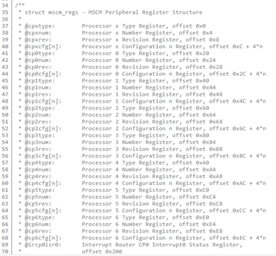

I want to porting a IPCF feature for IMX8M Mini.
I understand that a ipc-hw need MSCM address:

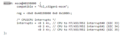

And definition the MSCM address in device tree:
But I can't find any document which mention MSCM for imx8M Mini.
