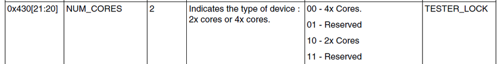

rans
Senior Contributor I
Hi Rita,
Thanks for the comments!
I verify it as following:
U-Boot> md 0x430 10
00000430: f8c50000 f8540100 f4400f80 e0367040 ......T...@.@p6.
00000440: f0406f20 e03b00c0 f4406f20 e0377040 o@...;. o@.@p7.
00000450: f4406f20 e0336040 f0406ee0 e00e0003 o@.@`3..n@.....
00000460: f0406ee0 e00a000c f0406ee0 e0060030 [email protected]@.0...
f8c50000 -> bit(21:20) = 00b  ->  It's QUAD !!!
Ran
3,987 Views
Rita_Wang
Hi Ran,
Here you can check the uboot fuse NUM_CORES, in our reference maunual you can see the 0x430.
i.MX6 Quad versus Dual differentiated by fuse NUM_CORES .
Rita
