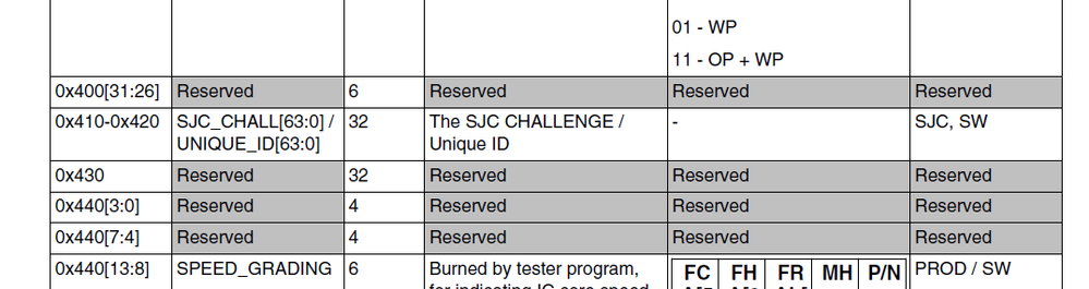

Step 12. fuse program
u-boot=> fuse prog 6 0 0xDA7CCBEB
u-boot=> fuse prog 6 1 0xD7D9F573
u-boot=> fuse prog 6 2 0x20DEBFD6
u-boot=> fuse prog 6 3 0x0E4AAC11
u-boot=> fuse prog 7 0 0xB0965A65
u-boot=> fuse prog 7 1 0x1A89C7DA
u-boot=> fuse prog 7 2 0x6D960E3F
u-boot=> fuse prog 7 3 0xE080A6D8
u-boot=> fuse prog 0 0 0x200
u-boot=> fuse prog 1 3 0x8000000
u-boot=> fuse prog 1 3 0x200000
u-boot=> fuse prog 1 3 0xC00000
u-boot=> reset
After resetting, iMX8MM can not bootup, could anyone help me clarify this?
I'm wondering what the correct way is or what steps I missed/wrong?

No HAB Events Found!
28,004 Views
mason2036
1. fuse prog 1 3 0x2000000 is enough to finish the HAB close the device. SEC_CONFIG[1] fuse
    You don't need to program others.
The others are related to the device SOC level security not HAB.
2.  - Program SJC_DISABLE:
This  fuse has no related to the HAB security. Open device still can disable  jtag. (no need fuse prog 1 3 0x2000000 )
3. - JTAG_SMODE:
This  fuse has no related to the HAB security. Open device still can use security jtag, which is called challenge. In i.MX is using uuid.(no need  fuse prog 1 3 0x2000000 )
Besides, when you disable the jtag, you have no chance to access the jtag, jtag challenge also doesn't exist.
So when you use  SJC_DISABLE, JTAG_SMODE, you don't need to program JTAG_SMODE.

To enable secure boot, as stated in (uboot-imx/doc/imx/habv4/guides/mx8m_secure_boot.txt at lf_v2022.04 · nxp-imx/uboot-imx · GitHub) you have to close device.
- Program SEC_CONFIG[1] fuse on i.MX8M family devices:
=> fuse prog 1 3 0x2000000
Yes, you can go ahead for Completely secure the device, just a note to "DIR_BT_DIS".
Normally this bit is already fused out of factory. You can read it before fuse.
More details, refer to 5.7 Securing the device of AN4581.
Harvey
