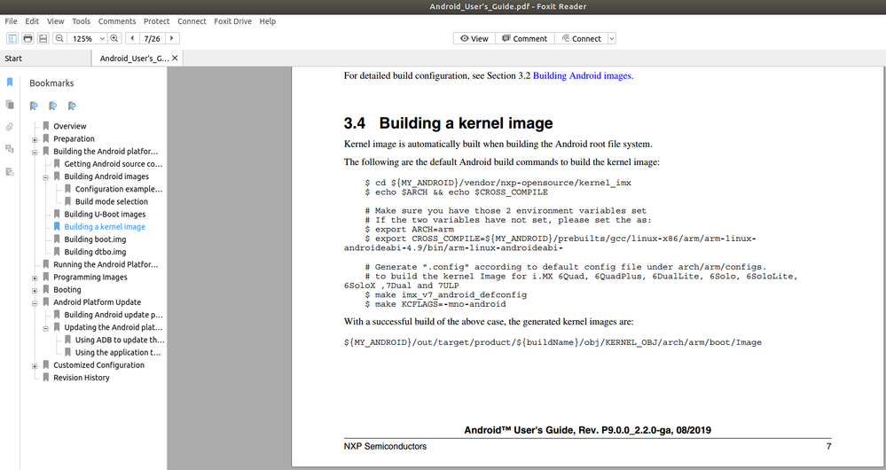

Which android version are you using? Below is an example for android 9.0
there's no file called .config either.
=> in this example do command $make imx_v7_android_defconfig. this step load defaul configuration and create .con file. Remember EXPORT cross compiler before doing config.

Thank you! I am using Android p9. I wonder when/how should I do the "menuconfig":
make menuconfig
as you did in step6 before building the kernel?
make KCFLAGS=-mno-android
When I do "make menuconfig", I see nothing under "Device Drivers -> Graphics support -> Bootup logo".
