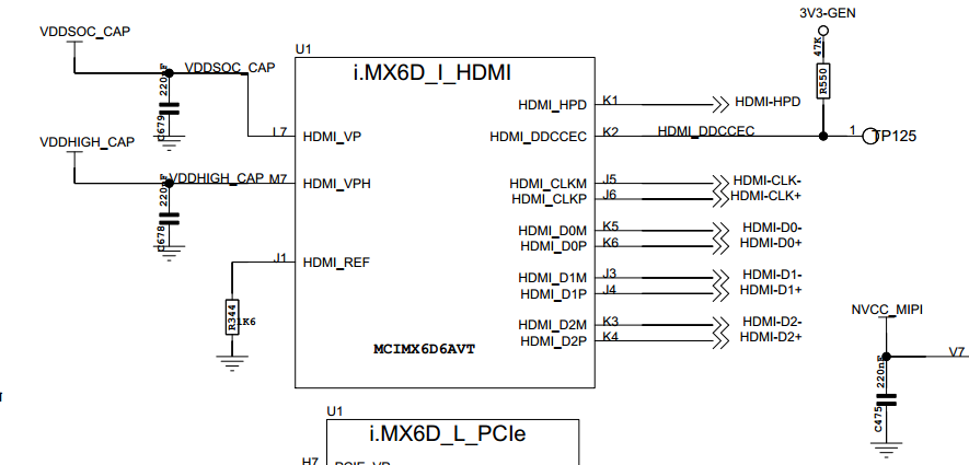

HI fsl, We need to use the HDMI interface. How can we enable HDMI?The following is a schematic diagram of HDMI:
My system is Android 7.0

igorpadykov
Hi yi
for using hdmi please follow i.MX6Q Sabre SD schematic:
 Schematics (1)
 Design files, including hardware schematics, Gerbers, and OrCAD files.
SABRE Platform for Smart Devices|NXP
and use software on below link:
https://www.nxp.com/support/developer-resources/run-time-software/i.mx-developer-resources/i.mx-6ser...
igor
