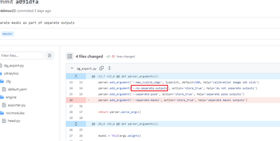

Zhiming_Liu
The code has changed, you can refer below commit. I think yolo export model=yolov8n.pt imgsz=640 format=tflite int8 is enough.
Zhiming

Joshua2
Hi Zhiming,
     Thank you very much for your help. The conversion issue has been resolved.
