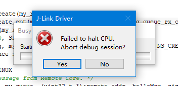

How to debug the cortex-m4 kernel using j-link on the i.MX 8M Mini EVK.
I had a problem debugging on the IAR.
The IAR version I used was 8.40.
The error is shown below

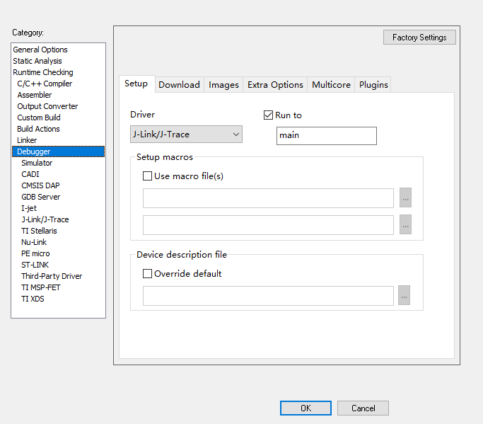

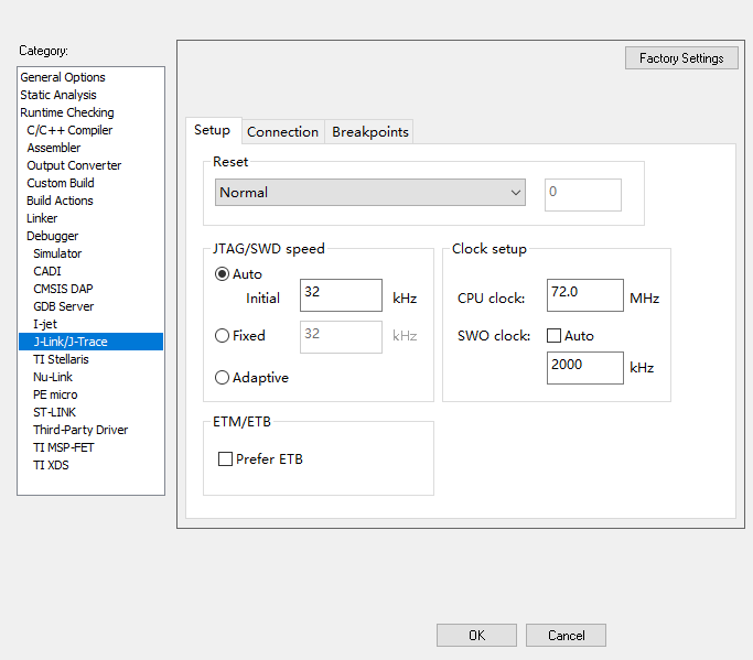

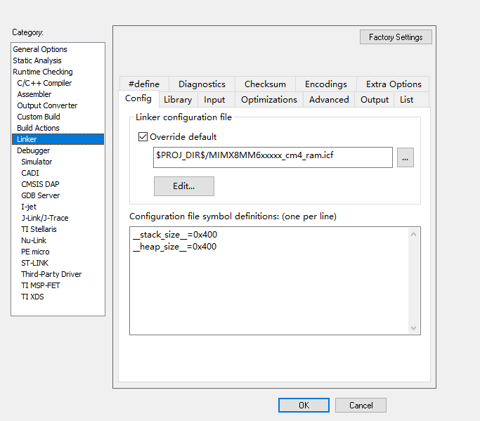

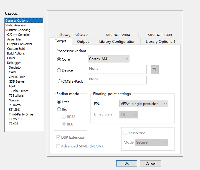

The following is my engineering configuration
