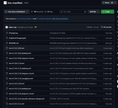

1. Initialize the repository with the proper manifest:
repo init -u https://github.com/nxp-imx/imx-manifest -b imx-linux-mickledore -m imx-6.6.36-2.2.2.xml

logic887
This only has version 6.1.36, not 6.6.36. I can compile Chromium using 6.1.36, but Yocto using 6.6.36 won't work.
https://github.com/nxp-imx/meta-imx/tree/scarthgap-6.6.36-2.1.0
I pulled yocto here
