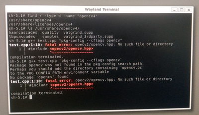

I have download and installed LF_v5.15.5-1.0.0_images_IMX8MMEVK from nxp official site. I can see opencv has been included in the image. But there are no opencv header files. So how do I compile a c++ program having  #include <opencv2/opencv.hpp> ?

The opencv4 folder should contains the opencv2/opencv.hpp, you can try to use "pkg-config --cflags opencv" to see it .
