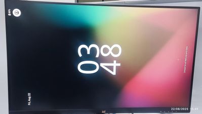

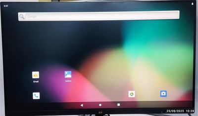

I am working on an i.MX8MP custom board with Android 10_2.3.0. I am trying to change the display orientation from landscape to portrait in my Android image, so I added the following changes in my .mk files.
diff --git a/imx8m/BoardConfigCommon.mk b/imx8m/BoardConfigCommon.mk
index 92197b61..2b105592 100644
--- a/imx8m/BoardConfigCommon.mk
+++ b/imx8m/BoardConfigCommon.mk
@@ -10,7 +10,10 @@ HAVE_FSL_IMX_IPU \
PREBUILT_FSL_IMX_GPU \
BOARD_SOC_TYPE \
PRODUCT_MANUFACTURER \
-BOARD_VPU_ONLY
+BOARD_VPU_ONLY \
+SF_PRIMARY_DISPLAY_ORIENTATION
+SOONG_CONFIG_IMXPLUGIN_SF_PRIMARY_DISPLAY_ORIENTATION = 270
SOONG_CONFIG_IMXPLUGIN_BOARD_PLATFORM = imx8
SOONG_CONFIG_IMXPLUGIN_NUM_FRAMEBUFFER_SURFACE_BUFFERS = 3
diff --git a/imx8m/evk_8mm/BoardConfig.mk b/imx8m/evk_8mm/BoardConfig.mk
index ed30f771..cd8f4c89 100644
--- a/imx8m/evk_8mm/BoardConfig.mk
+++ b/imx8m/evk_8mm/BoardConfig.mk
@@ -117,6 +117,8 @@ TARGET_USES_MKE2FS := true
# define frame buffer count
NUM_FRAMEBUFFER_SURFACE_BUFFERS := 3
+SF_PRIMARY_DISPLAY_ORIENTATION := 270
ifeq ($(PRODUCT_IMX_DRM),true)
CMASIZE=736M
else
When I set SF_PRIMARY_DISPLAY_ORIENTATION := 270, the output appears in
When I set SF_PRIMARY_DISPLAY_ORIENTATION := 180, the output appears in a
,but not in the correct orientation. When i passed the
$ settings put system user_rotation 3 command in android 15 means gives me the correct_portrait_view
However, this command does not work on Android 11.
I will attach an image showing the orientation I am expecting in Android 10
Thanks &Regards
Subash.P

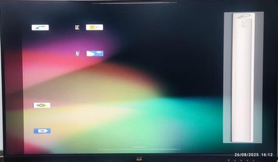

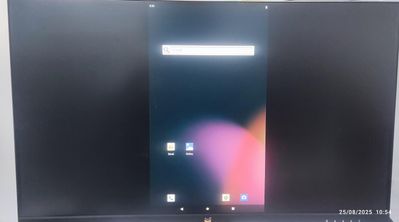

surfaceflinger rotation information will not pass to HWC in Android10, please try the attachment in HAL and use 'settings put system accelerometer_rotation 0/1' for test.

Hi @Zhiming_Liu
After applying your patch, I can see some changes on my screen, but the resolution is not good. Also, when I connect a mouse, it works in the way of landscape navigation, not in portrait navigation.
And also, the navigation bar is not visible.
Subash P.
