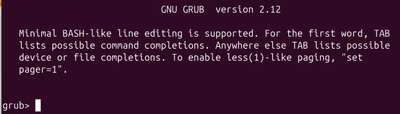

Hello.
I just started work with Android at IMX8MP base processor.
I used all sequence described for building process.
In final I flashed SD card with:
sudo ./imx-sdcard-partition.sh
And when I start the board evk_8mp, I see just:
But how I can start the Linux itself?? What is the wrong?
Thanks.

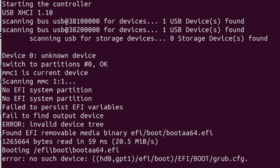

Axent
I found that I have errors during the booting:
How can I build Android image to run it from SD card? I follow all instructions in Documentation (Android's user Guide)
I can build and flash the image. But it doesn't start from the box.
759 Views
Bio_TICFSL
You forget the MX8 switches to eMMC, please check the userguide for this:
https://www.nxp.com/docs/en/user-guide/ANDROID_USERS_GUIDE.pdf
