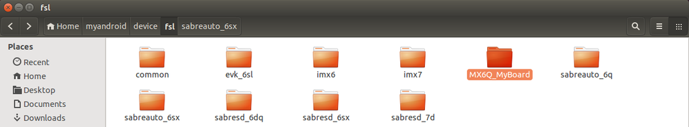

    It is not difficult to add a new board to android source code if your board is based on i.MX6 evaluation board, I only give you general steps, see below:
asume your board's name is: MX6Q_MyBoard
(1)Creating directory For the board
Open "myandroid/device/fsl/", and create a directory named "MX6Q_MyBoard".

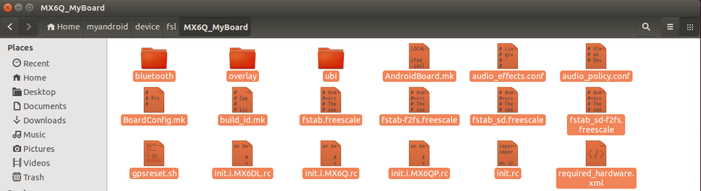

(2)Copying all files in sabresd_6dq to the directory
If your board is based on sabread EVK, copy all file in sabresd_6dq to MX6Q_MyBoard
(3)Changing configurations in BoardConfig.mk to yours
Check the file carefully, and modify some contents, such as device/fsl/sabresd_6dq, it should be changed to device/fsl/MX6Q_MyBoad, TARGET_BOOTLOADER_BOARD_NAME := SABRESD to  TARGET_BOOTLOADER_BOARD_NAME := MyBoard, etc. That is to say, you should change all information on sabresd to be yours.

(5)Creating MX6Q_MyBoard.mk file in current directory
In device/fsl/imx6 path, create MX6Q_MyBoard.mk file, and copy all contents of sabresd_6dq.mk to it.
Then according to your schematic, adjust correcponding configurations, don't forget it.

   OK, generally speaking, you need to do above 6 steps, then your products can be compiled independently, but don't forget to modify configurations to be in accord with your board.
  Hope these steps are helpful for you!
