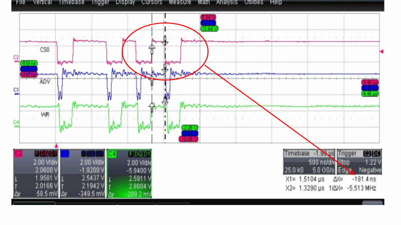

  1. When I was using a for loop to send out 16 bit words on the WEIM Bus:
    So when I captured this waveform, I was sending out 4 words (16 Bit, DSZ).
    Time taken in the transfer is around 2 micro-secs, throughput 32 Mbps (32Mbps).
    There is a huge dead time of around 180 nanoSecs between two successive writes.This dead time was a pain because I could not find any configuration in the WEIM Config registers that could be used to change it. I tried reducing WWSC from 32 to 8, this reduce the CS assertion time, but the CS dead time remained stuck at 180 nano-secs.

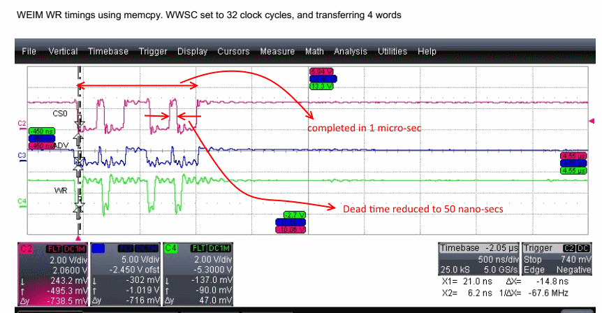

  2. WEIM bus timings after changing the implementation to use memcpy()
    Time taken for the 4 words transfer is 1 micro-sec, so the throughput is about 64Mbps (doubled, but still not good enough).

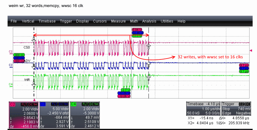

    On changing WWSC to 16 WEIM clock cycles (from 32), the throughput increased further:
    32 words(16 bit) transferred in 4.9 micro-seconds, throughput of 104 Mbps.
The throughput can be increased further by reducing the WWSC value.
