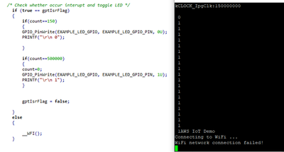

ahhhhhhhhhhh
I use kCLOCK_IpgClk as GPT Clock and set the compare value as 150.
I count the interrupt number, and after 200 and 500000 counts, change the GPIO_pin, it can work well, as the picture shows bellow:
 But if after 150 and 500000 counts to change the GPIO, It cannot work.
