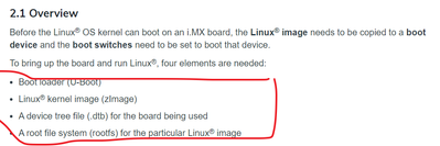

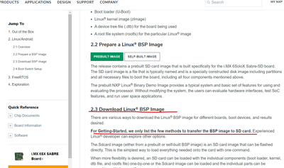

开箱即用时,如何将BSP映像传输到SD卡?下载bsp并复制并粘贴?
为了容易使用开发板,如何保证下图中的4个条件?

This is the Linux BSP (board support package) release web page. You can download the demo image and the documentation from this web page.
https://www.nxp.com/design/software/embedded-software/i-mx-software/embedded-linux-for-i-mx-applicat...
for example : Linux 5.10.9_1.0.0​
For how to program the images to your board, please read the i.MX Linux User’s Guide​.
For how to build the images, please read the i.MX Yocto Project User’s Guide​ .
For a quick start, you can download the demo image (i.MX 6QuadPlus, i.MX 6Quad, i.MX 6DualLite, i.MX 6SoloX Boards​) and then follow the Chapter 4.3.2 "Copying the full SD card image" in the Linux User's Guide to program the demo image to the SD card.
