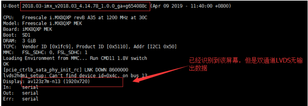

But can't drive my screen 1920x720p (the timing I have added to panel-simple.c), the error is reported during initialization, the corresponding error message is as follows:
How can I modify if there is an error in configuring the device tree? I hope to get your help, thank you!

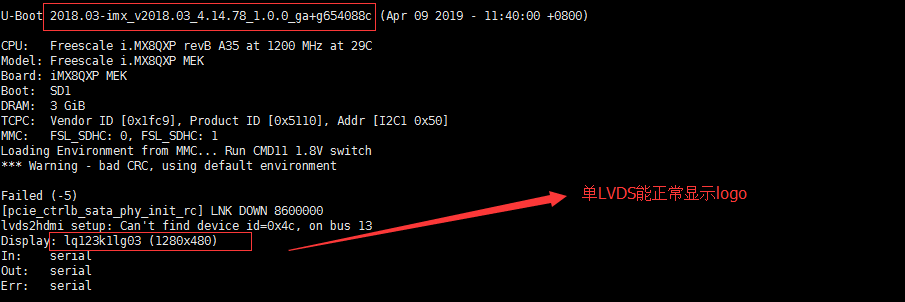

If I want to configure uboot show logo, should how to modify?Single an LVDS we can display properly, don't know what to pass kernel parameters, able to provide the corresponding documents?Thank you very much!

baijinlong
The above is my configured for single can display properly when an LVDS - 1280 x480, when I change into a double an LVDS screen, don't know how to configure lvds_configure (int lvds_id) function, switch to dual channel an LVDS (SPLIT MODE), how do I configure?  In detail how to modify???????????

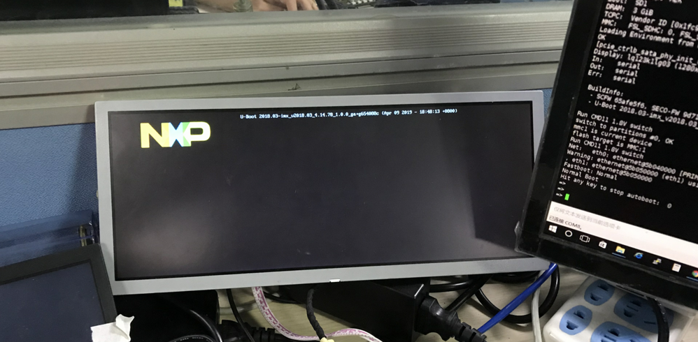

Before this I know, because I drive screen is single way an LVDS, already all ok.So also add;Now we use double channel an LVDS driver we screen is there is a problem, can't drive.Is more than the TXT attachment tip error.You said the display of the logo I am an LVDS has shown correctly in a single road, but change the dual channel after an LVDS Gao Qingbing cannot display, driver error...

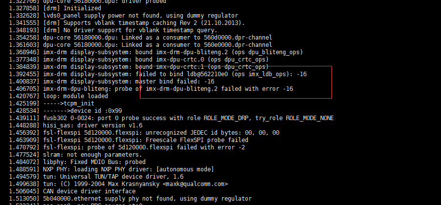

baijinlong
I have replaced the latest firmware, but also added a timing reference jdi_tx26d202vm0bwa_timing, but start the error ( imx-drm display-subsystem: parent device of /ldb@562410e0/lvds-channel@0 is not available  );The corresponding debugging information in the log. TXT inside;Hope to provide some help!
