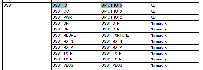

We are designing New project by using I.MX8MP.
To decrease MC, We remove USB3.0 function.
So, We need USB_ID pin control.
I checked Datasheet and Hw check list. But I do not find contents of USB ID.
Please help me.
